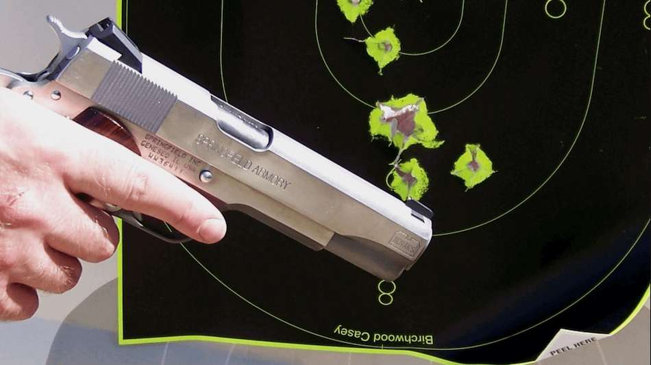

Springfield Armory 1911 with a Shoot-n-See target
As you practice, you will notice a wider dispersal with the greater speed you attempt—keep the shots centered.
